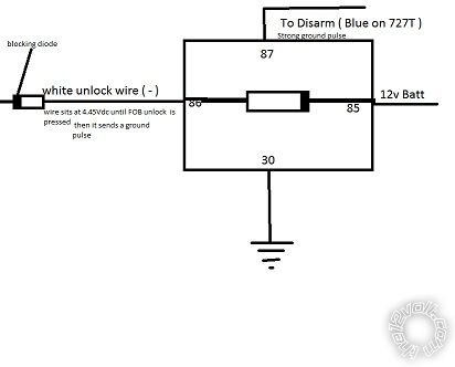

OK. I think I may have found a solution for the unlock wire if I'm not able to get it at the door switches since there is vitually no way to pass it through the door grommet.
The white unlock wire sits at 4.45Vdc until the FOB is pressed then it pulses a ground. Second press on the FOB pulses ground again but by that time the system will be disarmed already.
What I am going to do is this. I've verified it works perfectly. See any potential problems?

Posted: October 29, 2011 at 8:13 AM / IP Logged
May work, but 30 should be 12volts to send a 12volt pulse to the 727T.

Posted: October 29, 2011 at 9:18 AM / IP Logged
Got ya. I was thinking about that too. I'll keep them all at 12V to the 727T. It works also making the common ( 30 ) on the relay. I've confirmed it.

Blue # to white 18 gauge wire at the DKP. The white wire sits at 4.5V at rest and puts out a ground pulse when the FOB is pressed. As a safety measure I used the attached relay schematic to protect any back feed into the truck.
