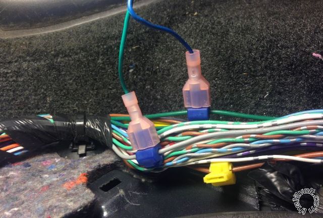

Just want to update if anyone else needs this lock and unlock connection wires color.
Lock === Gray
Unlock == Green
On 2011 Nissan Altima Sedan 2.5S - At kick panel.
2010 Nissan Altima PTS Remote Start Pictorial - Page 5 - Last Post -- posted image.
