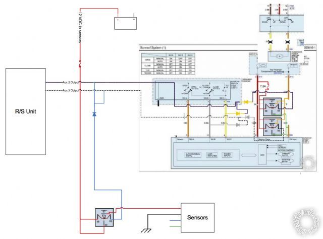

In the first picture, you need to make orange at 3 constant, then ground either the grey or yellow to tilt close or slide close.
So you have an aux going to 85 of your relay, 86 87 constant fused 5 amps, cut the orange, 30 sunroof module and 87a to fuse
Diode across the relay and a "Y" split, both sides diodes and the other side of that aux, set for about 7 seconds linked to arm to either the grey or yellow.
Bet it does the trick.

You mean this is for closing the sunroof only, i think that the yellow is only to tilt the sunroof up as in the table in the top left of the first picture (sunroof schematic)
To tilt close (down) should be signal B (grey wire is the only that should be on), it takes about 2 secs (timed it with stop watch) to tilt up or down so should i still time the AUX to 7 sec or enough about 3 or 4 secs.
i don't understand "Diode across the relay and a "Y" split, both sides diodes and the other side of that aux"
and how will i imulate the switch on of the grey wire, should i use another relay?

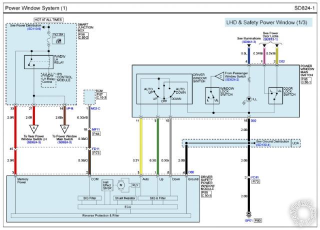

And what about the power safety window of the driver side, schematic of windows 1/3

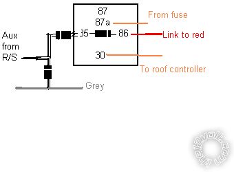

Try this:- roof.bmp
Still can't see the driver's motor.
You are attempting too much, any mistakes will compound each other/multiply.
Get ONE THING at a TIME RIGHT.

If either green, yellow or grey don't show 12V+ on up/down, don't touch it.
Try and measure what the switch is doing.

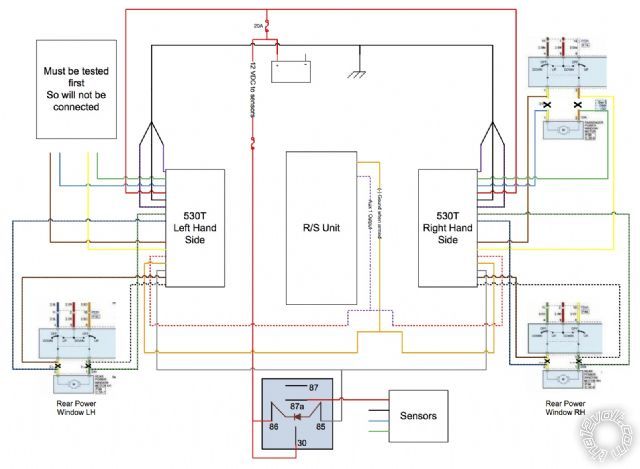

i made the schematics for installation of the window modules and for sun roof as you advised me
viper 5902 + dball in hyundai 2012 - Page 14 - Last Post -- posted image.
Posted: March 14, 2013 at 10:36 AM / IP Logged
In theory you shouldn't need either relay, I'm sure that whilst R/S is on those sensors are disabled.
