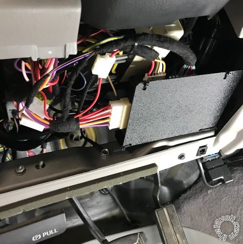

Key points:
If you have a 99-01 7.3 Powerstroke get your tach signal from behind the cluster!
Also, all tech info describes the wire as white/pink, but the wire is more of a tan/off-white color with a pink tracer.
A great place to stick the brain on these trucks is lower brace for the knee panel. I just built a simple ABS bracket for it (this pic is before doing a final clean up on wiring).
2000 Ford F-250 7.3 Diesel, Viper 4806V Install - Page 2 - Last Post -- posted image.
