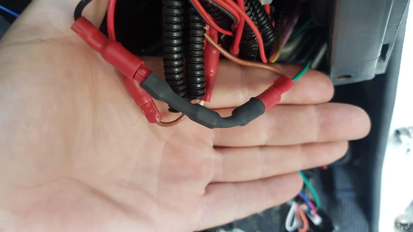

How do I get a lone component like that inline with car wiring though? I could drop one into the holes of a bread board andsolder one in but never had the need to put a lone component into car wiring. Soldering wires straight onto diode terminals would be pretty ugly even for me.
I can find spade fuse shaped diodes that would fit into an inline fuse holder.
henno
Member - Posts: 9
Joined: July 27, 2020
Posted: October 03, 2020 at 10:42 PM / IP Logged Link to Post Post Reply Quote henno
Thanks mate. I crimped the diode onto bullet terminals an put heatshrink on the whole thing. Works a treat now.
