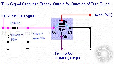

This... https://www.the12volt.com/relays/relaydiagram22.html
With using the capacitor across the relay coil, the load current (cornering light) doesn't effect the 'on' time. The capacitor keeps the relay coil energized between flashes, and slightly after the turn signal is cancelled.

Ok lets see if I understand everything.
The pink wire out of 86 represent the pulsed signal coming out of the flasher relay.
I need to connect one side of a 10k resistor and one side a 10kuf capacitor to that line. Then that line continues to my LED light.
I then need to link together the other side of the capacitor and resistor and ground them.
Resistor
Capacitor:
Are those the needed components?
Anyone can explain to me why I need to ground the capacitor and resistor and why a resistor is needed?
Thanks
Ween
Platinum - Posts: 1,368
Joined: August 01, 2004
Posted: September 06, 2021 at 5:06 PM / IP Logged Link to Post Post Reply Quote Ween
The resistor (10k ohms) isn't needed. The capacitor needs to be grounded so as to be able power the relay during the time when there isn't power being supplied through the diode. The diode is needed to isolate the power coming from the flasher. If it wasn't there, the capacitor would discharge into the front turn signal circuit.

Thanks Ween for the explanation. After more research I plan to go with those components:
Capacitor: Radial Electrolytic Capacitor 25V 10000UF 105C
Diode: HUABAN 1N5400 Rectifier Diode 3A 50V
Are those the right ones for my project?
Ween
Posted: September 07, 2021 at 9:23 PM / IP Logged Link to Post Post Reply Quote Ween
A 3A diode is a bit overkill for the project. 1N400* series diodes would be fine, !N4001 or !N4002.

If u need a resistor to keep the blink-rate it may be solved like this
( modified version of : https://www.the12volt.com/relays/relaydiagram22.html )
If u got a LED blinker relay u don't need the 10k resistor

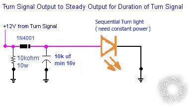

Posted: October 31, 2021 at 12:09 PM / IP Logged Link to Post Post Reply Quote pfix
Here is what I used on a CBR1000 with "aftermarked" LED sequential rear turn-signals :
How To Transform An Intermittent Signal To A Constant One? - Last Post -- posted image.
I plan to install LED's in the front turns also, then the 10k resistor will not be needed anymore :)
