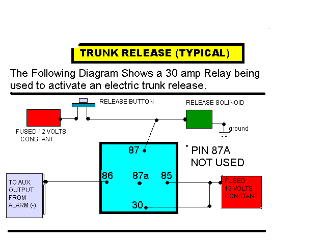

One thing that I'm still working in is the trunk release to work.  I have looked up different diagrams in wiring my relay but there must be something I'm doing wrong.  the diagram tells the that the wire is PURPLE / tan (-) requires relay, location at the trunk switch.  I found the wire and noticed that the wire rests at a positive voltage until the swith is pressed and then shows no voltage.  First, I tried to hook up my gray wire from the alarm module (acc #1 trunk release, neg out, 250Ma) it worked once or twice and then it stopped working.  Then I tried to use with relay using this diagram, this didn't work either.  What am I doing wrong???????? 2007 chrysler 300, base model -- posted image.

Sound like you fried the output of the trunk release from you unit. Test it with a meter to see if its still working.
