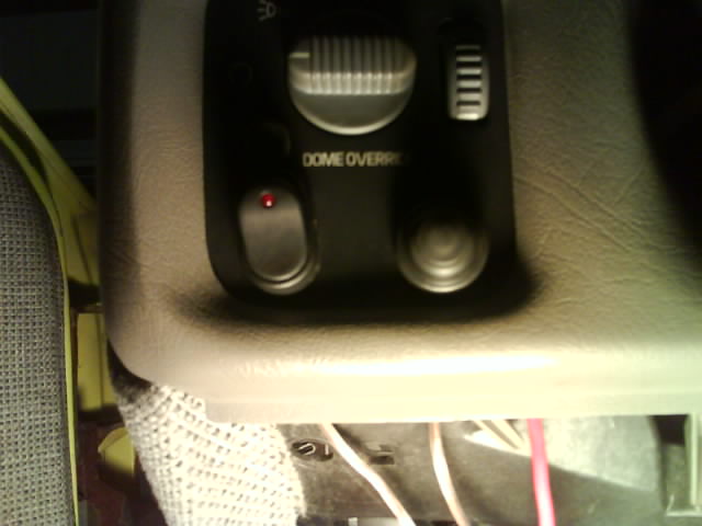

yeah ive got that shroud off.. and everything looks normal...this is where i clipped to measure resistance.
under the dash by the column hes tapped a few wires, looks like power source to door popper.. but no 22 gauge wires were cut just the 18 gauge stuff like the starter wire.

also i need to clarify the switch on the dash is NOT the typical cut the yellow wire and put a switch in type switch...  when you flip this switch it turns the power on to the vehicle (like a race car)

i really think it has something to do with the flip switch to power the truck, and how the guy wired this thing.. its a rats nest under the column, and the guy just twisted wires together.. ive spent the past week (only about an hour a night) untwisting, and reconnecting via butt connectors and spades.
does anybody here have an actual wiring schem. for this thing so i can put it back to bone stock and start from scratch, rather than chasing down problems from the previous installer.
below are some of the pictures depicting what im talking about with the wiring mess.
