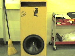

box for re sx12 -- posted image.
this is my 18" SX but you get the picture. this box is right around 5.5 cubic feet including the port volume. my port is 3x18x26 and is tunned to about 30hz so i get really nice bass response down to the 25hz range
i might also add that this is the second box that i built for this sub. the first box was about the same general size but the port was only 2 inches wide and about 10 inches shorter. i only could hit about 142DB with the first box, which is still loud, but it is insulting for an 18 in a small truck. so i used trial and error and adjusted the dimensions and gained about 8-9 DBs. this just goes to show that building the right ported box can be tricky, so you might want to build 2 boxes to compare so you can pick the one that sound best
