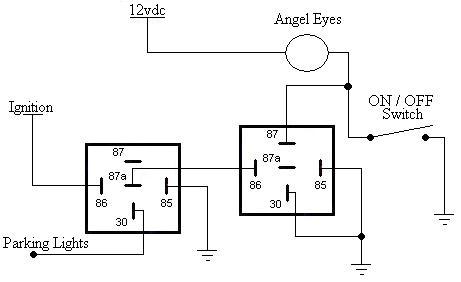

Here's what I came up with:
blinking angel eye -- posted image.
Basically, if the ignition is off the parking lights will control the angel eyes.  If the car is running the parking lights will have no effect on them.  This provides no protection if you were to walk away from the car with them turned on, since you stated you wanted them tied directly to a constant hot wire.
The second relay simply converts the polarity of the parking light signal to be a (-) to work with the constant hot.  If you switched the ground instead of the hot you could eliminate the second relay (the one one the right).

correct me if i'm wrong kevin, the setup above will work, but if the car is running and the parking lights aren't switched on, then won't the relay on the left buzz as it isn't energized properly, and don't you mean if he switches the hot instead of the ground, again correct me if i'm wrong,

The relay on the left will be completely energized, it shoudln't buzz at all - it will have 12vdc across the coil.
He requested the the ground be switched and that the lights be fed with a constant hot feed.

are you positive about that,(i use the poles in reverse as to the way you do, i dunno if it makes a difference, so it could be my ignorance) yes it will have 12 volts across the coil but only when the parking lights are on, but when it's off i mean, like during the day, and i meant about eliminating the second relay he would have to switch the hot instead of the ground, again correct me if i'm wrong.

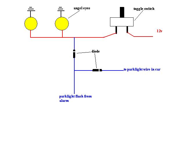

you dont even need relays. just use a couple of diodes to do what you want. below is the diagram.
