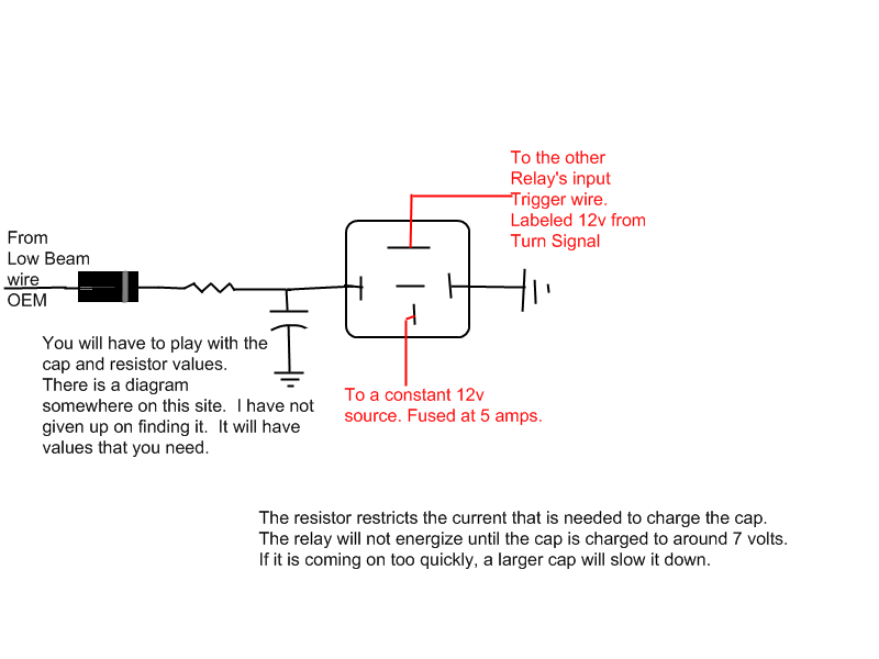

Platinum - Posts: 13,726
Posted: April 29, 2009 at 7:30 PM / IP Logged
I thought that was exactly what you said in the beginning. That is exactly how it will work. Build the one that I posted earlier and use a larger capacitor to see how long it will stay engaged when the power is removed from the trigger wire. The above is the delayed off relay. The delay on circuit will trigger that one.
I still have had no luck finding the other diagram.  Give me a minute, I will draw the diagram, you will have to play with the cap and resistor values.

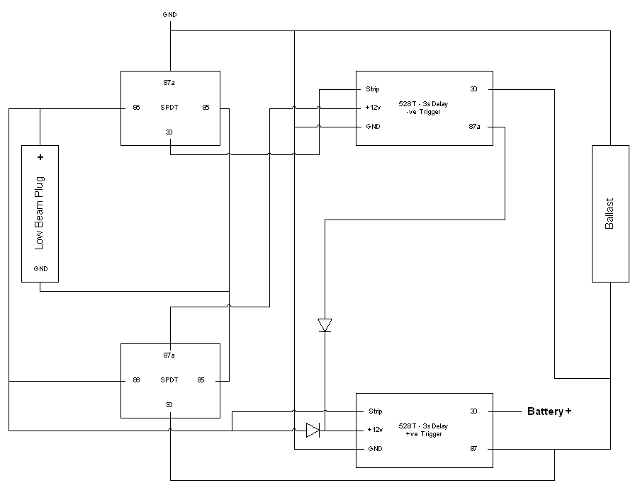

I'm novice on circuit design, and I'm not sure the following will work or not....

Posted: April 30, 2009 at 1:32 AM / IP Logged
i am an idiot wrote:
any relay do this? -- posted image.
Is it means the relay will only energized after a couple seconds (delay on), then when low beam off, the capacitor will discharge and energize the relay for a couple more seconds (delay off)? Wow, it is much simpler than what I comes up with.... What resistor and cap size should I start with, if I want aorund 3s delay?
