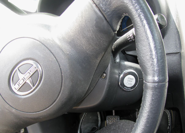

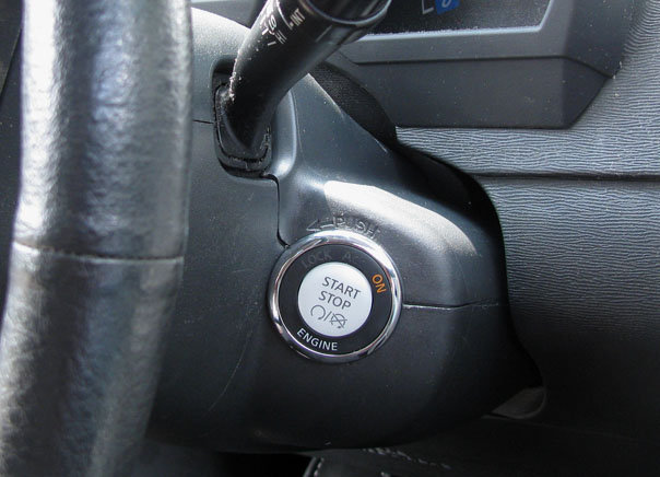

I have installed Star Drive in two cars a VW Golf and a Scion XB it is the most complete kit I have found, Comas with Smart key fob's that operate the door locks and keyless ignition from like 10 ft away.
And yes for the full keyless experience you need to un-do the column lock.
Some customers don't have the nerve to go for it. If you ever had a car stolen the column is always broken anyway.
The next install is a 69 Camaro with no column lock or immobilizer to bypass.
Here are some pics sorry did not get any of the VW.
push button start without keys - Page 2 -- posted image.push button start without keys - Page 2 -- posted image.
