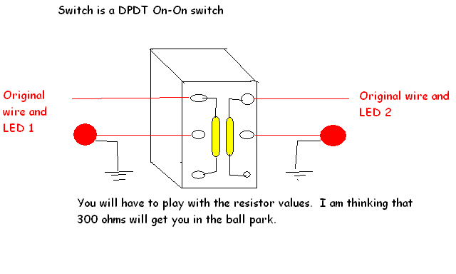

Hi guys I put 2 super bright LEDs in my dash(they tell me that the ECU is running in closed loop and other functions too)the normal LEDs in the day time where to dull and these are too bright at night so I wanted to put a DPDT switch in with one/two Resistors on the switch to have one position for full power and the other position say half power for the night time..
The two LEDs are 3.6v each and are wired Independent of each other(one lean mixture and one rich)
How do I wire this with the switch and what Resistors would I use?
Thanks guysleds -- posted image.

What value resistor are you using currently?  Or does the controller only put out 3.6 volts?
Thanks, I just knew I would leave out somethingleds -- posted image. Yeah not using any resistors as the outputs are 3.0v leds -- posted image.

Platinum - Posts: 13,726
Posted: June 14, 2009 at 11:19 PM / IP Logged

Hey I'm back with a update and I couldn't get any 300ohm Resistors so I got some 328ohm ones and tried that today and you can see the difference when you flick the switch but is still to bright...
Then I did something else and scratched my head as it didn't seem to make any further change and that was to have 3 Resistors in series!
Help please leds -- posted image.

Was there any difference between one resistor and the 3 in series? If it did make a difference but it was only a minor difference, try a 2.2K or a 3.3K. If you had 3 of the 328 ohm resistors in series, you had a total of 984 ohms. or basically 1K. If it is a task to get to the parts store, get several values between 2.2K and 10K.

leds -- posted image. leds -- posted image. I have put all 15 Resistors together and now have a total ohms reading of 4.49K and is getting better but still a bit to bright...
No difference between one resistor and the 3 in series!!!
sorry I was doing this and then seen your replyleds -- posted image.

Don't worry about the odd ohms reading as it was made up of 5 328's + 5 224's + 4 380's + 1 40 resistors leds -- posted image.
OK I'm off to the store and get what suggested and will try that..
Be back with some newsleds -- posted image.
