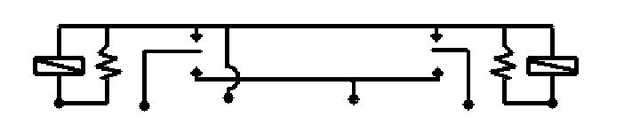

cm3000, many problems -- posted image.
i have the proper relays but only 2 and i need a 3rd for the trunk release to work, was wondering the relay above would do the job for the door lock relay for both lock and unlock, it is a gm lock/unlock relay that is already in the truck, but i do have another one, will it work? if so, how ould i hook up?

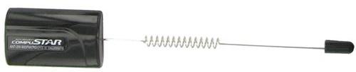

as for the antenna, it looks like this, but there is no model number or anything on it, has 4 wires going in
never mind this post, i found a 3rd relay to use on the trunk release
