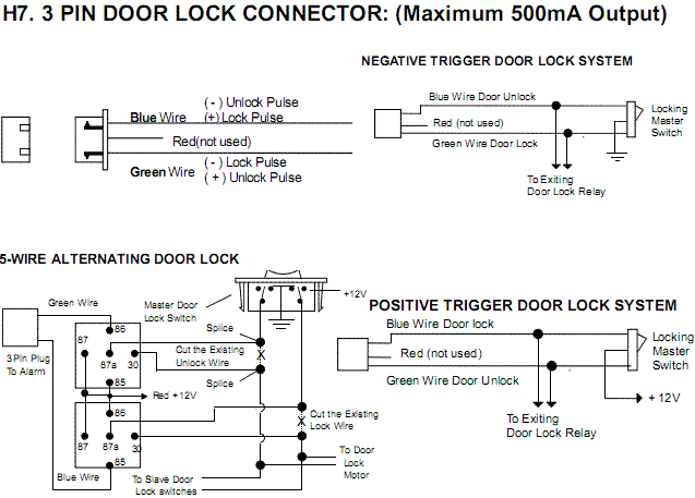

I was wondering if anyone has had any experiences with Autopage specifically RS-900 my question is the door lock and unlock wires. the alarm has two wire that both lock and unlock so my question is
How do make the wires send out positive or a negative pulse? I was looking to see if they were programmable but no luck...
autopage lock/unlock -- posted image.
I Have a 2004 Corolla LE
POWER DOOR LOCK   -- GREEN (-)
POWER DOOR UNLOCK -- BLUE/BLACK (-)

you hook them up based on the type of locks in the car. if the car has positive locks you use the blue for lock and the green for unlock. if you have negative locks then you would do the opposite.
you can also use it the same way to activate a relay for reverse polarity locks or anything else that would need a relay for.

Yep when the polarity changes...So does the function...There is nothing to change in programming...Green wire from alarm goes to green wire in car...Blue wire from alarm goes to Blue/black in car...Connect them and will be locking/unlocking in no time...!

As promised. The install was a sucess I want to thank you all for the responses.
