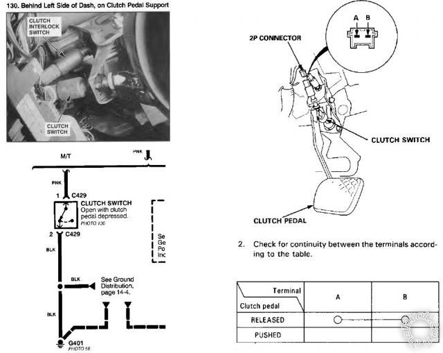

Seems to be a little confused. Here's the clutch switch circuit for my car.
viper 5901 won't rs on 98 integra -- posted image.
I unplugged the clutch switch and tried to start the engine with the key with the clutch depressed and I could still start it. Why?
I found several methods of clutch bypass from the following website and I'm not sure which method actually applies to my car:
http://www.velocitymotorsport.com/images/install_notes/146.jpg
http://www.velocitymotorsport.com/images/install_notes/107.jpg
http://www.velocitymotorsport.com/images/install_notes/119.jpg
http://www.velocitymotorsport.com/images/install_notes/120.jpg
I used a Digital Multimeter and measure the voltage at the clutch switch and it turned out all negative with and without clutch depressed.
