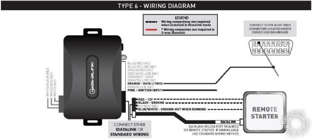

I am a little confused.
This is the wiring diagram I found for this vehicle's installation type.
The "Pink - Ignition Input" - is incoming to this unit? Or is an input for the ignition wire?
I guess it really doesn't matter, it needs to be placed in-line with the ignition wire. Correct? How does it disarm the Passkey II? Is it through the data port or through the ignition wire input?
2001 alero passlock ii -- posted image.

Posted: December 14, 2009 at 11:42 AM / IP Logged
its data.  not sure which alarm you have but the ignition input on the moduel connects to the igintion of the car.

Posted: December 14, 2009 at 11:44 AM / IP Logged
Okay that makes sense. I was just confused because other modules show 3...4...5 connectiosn to the steering column wiring harness and this only shows 2.
