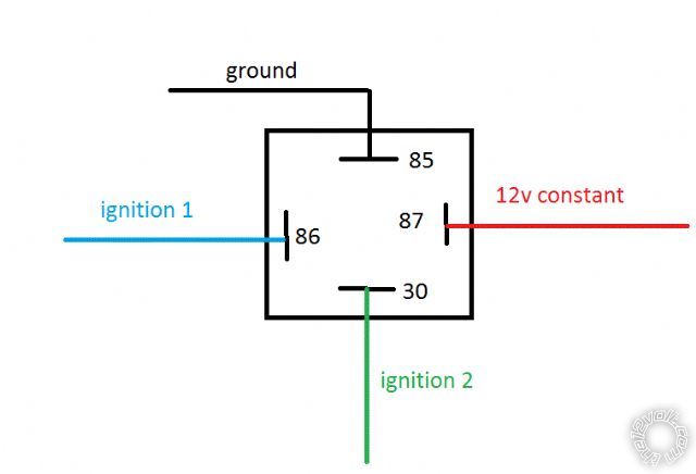

Ok I think I figured out what went wrong. I think I had the relay to the 2nd ignition wired wrong. Let me go over how I have it wired.
No that 85 isn't dedicated to ground in tedmond's description! That's the trigger for the respective output!
I used T&t's explanation below:
Here's another way
Pin 85- ground
pin 86- To starter wire or accesory
pin 87 - fused twelve volts at 20 amps
pin 30- to the respective wire depending on where you connected 86 (meaning if you were connecting second starter relay, pin 86 would go to the first starter and pin 87 to the second starter) Drawback to this is they will be powered with or without the remote start.
Here is what I made with those directions:
2000 nissian sentra remote start - Page 6 -- posted image.
Is that relay wired up correctly to work ? These relays will be the death of me......

Why is ignition 2 connected to pin 87? Connect the ignition 2 wire of the car to pin 30, exclude the wire from the remote starter that is on pin 30 and the rest remains as is!

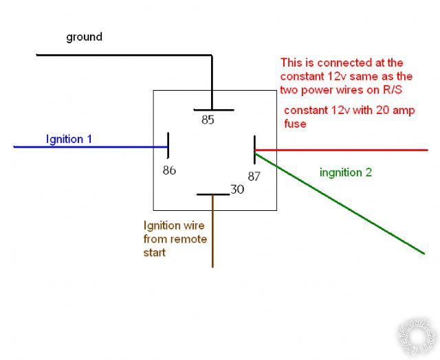

Thanks for your help, here is what I have now:
Ok, so i assume I attach the ignition wire from the remote start to either of the ignition wires of the cars wiring harness correct ? Then I connect the relay ignition wire 1 on the relay to the same ignition wire that the remote start is hooked up to. Then take ignition wire 2 from the relay and connect it to ignition wire 2 on the car. The relay I purchased didn't have a harness or a harness I could buy for it so I just purchased some 18g wire.

Yes you  are correct in your assumptions! Also you should use at least twelve gauge wire for the purpose that the relay is going to be serving!

Looks like I will have to go back and get some 12g wire then. Thanks.
