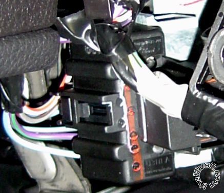

The Fusions ignition switch harness has a 7 pin plug. There are 6 wires in the 7 pin plug. The wiring diagram shows what 5 of them are. I'm not sure of the sixth.    Here is the fusion wiring diagram:

I have tested and verified the function of the wires on the ignition harness. I'm still trying to figure out what the sixth wire is. The terminology that Viper uses is a little confusing to me and I am hoping you guys can steer me as to which wires from the H3 go to which wires on the ignition harness. Have no idea what a flex relay 87 is for. I believe I have to cut the Blue/White starter wire and use the Violet and Green wire from the H3 on it. I'm not certain on which accessory wire to use on the H3. I will run a wire from the battery for 12 volts if that is the best method. Hope to hear from you soon!

I have tested the unlisted wire in the diagram.2010 Fusion- Ignition Harness-7 pin plug - pin number 3 is 12 volts constant. It appears to be grey with a brown or possibly black stripe. Don't know why its not in the diagram. Still hoping to hear from you guys on the wire connections on the H3 harness. Thanks

(GY-BN) 18 CTRL MOD. - POWERTRAIN # TRANSMISSION RANGE OUTPUT PARK (TRO-P)
it goes to the floor shifter

Thanks Chev. I didn't think to check it after changing gears. Sure enough, 12 volts when in park, 0 in the others. I would have thought that it would show 12 volts in neutral also, but it doesn't. It will start in neutral though.
