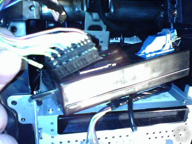

Posted: April 30, 2010 at 12:47 AM / IP Logged
Here are some pics of where I installed two relays for the defroster and heated seats. I also have the DTIMAZDA module mounted here. Easily accessible through the side opening on the dashboard.2010 ford fusion, viper 5901 - Page 5 -- posted image.2010 ford fusion, viper 5901 - Page 5 -- posted image.2010 ford fusion, viper 5901 - Page 5 -- posted image.                                Foam wrapped over relays to prevent rattle.   Sorry pics so small, used phone camera.
