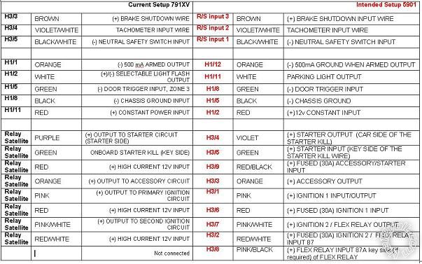

Hi all
I finally gotten the new 5901 and I'm planning to have it installed in my Honda FRV. I'm currently using the 791xv and I trace the wires of the existing setup with the 5901. I have copied down all the wires that are currently in use with the 791xv and I'm identifying them with the 5901 wires. Can someone please help me if I'm doing the right? Also, the Tachometer threshold was set high and light flash polarity postive for the 791xv. Please kindly enlighten me what are the necessary things that i need to do after the connection below. Thanks in advance!
viper 791xv to viper 5902 -- posted image.
t&t tech
Platinum - Posts: 2,622
Joined: October 05, 2008
Location: Trinidad and Tobago
Posted: March 25, 2010 at 6:17 PM / IP Logged
Yes just as you have it (assuming all the original connections are sound and the previous starter was working you should be fine), leave the tach settings on the new unit as is, don't forget to learn the tach!
fierywheel
Joined: December 25, 2009
Posted: March 26, 2010 at 12:25 AM / IP Logged
I've hooked up everything and everything worked perfect. Thanks!
There was a mini fuse inside the box and I didn't hook it up.  Do I need to set both the parking light jumper and hook up the mini fuse to positive polarity if last 791xv setting was positive?
