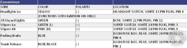

I'm planning to install the Viper 5701 alarm on my Kia cerato forte 1.6EX (2010). However, i'm have some problems understanding the way the parking lights should be wired to the brain.
1) Is there a difference between parking lights and hazard lights? I did some reading up and it seems that parking light referings to the first "click" when you turn the light switch. If that is the case, why should there be a L and a R wire for it? Does the parking light in this case refer to the hazard light?
2) From the wiring diagram of the viper, the parking/hazard lights should be wired to the white wire in H1. However, how do i wire up both L and R of the park lights? According to the wiring diagram from www.wirewerx.com (which i bought), there is another green wire in the car which is "All Hazard Lights", and it is -ve trigger. Should I be wiring this green wire to the viper system's white wire instead?
Would really appreciate if somebody can enlighten me about this.
Here is some wiring diagram for my car.
kia forte viper 5701 parking light -- posted image.

change the jumper on the remote start unit, to negative output, and you can use ORANGE, at the headlight switch, and save your urself some unessicary wiring.
but to answer your question, you could use 2 diodes and isolate L and R parking lights, or you could use 2 relays, and isolate L an R parking lights that way.

I'm intending to connect the white wire to the green all hazard lights wire at the vehicle. Will this work?

I did this car the other day and just grabbed negative p.lights at the switch. No extra dismantling/searching since it's right there by your main ignition harness.
Also, might need to wire up a relay to connect to the key cylinder and 2nd accessory to disable the car from cranking briefly during key takeover. I had to, atleast.

Look at the wiring diagram you posted. Right under the + p.light wire, it lists a - p.light wire found at the switch. Super easy to grab it here, just make sure you set the fuse to - on the viper unit.
And parking lights are not the same as hazards. Parking lights are usually just the corner lights turned on, or the "first click" as you refer to. Hazard lights are your turn signals...

You have parking lights in your tails, also. Hook up to the parking light wire and forget about the hazards.
And by default the parking lights will flash with just about everything including lock, unlock, remote start, alarm (obviously), but it's also programmable if you only want them to flash with certain functions.
