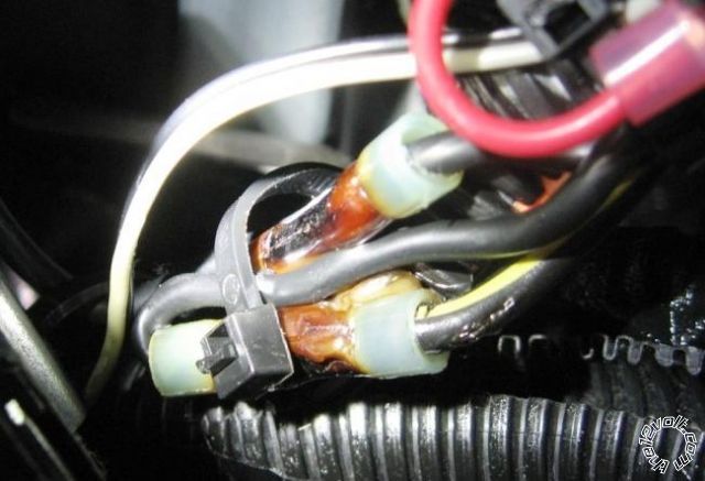

I was poined to this forum and therefore new here. Earlier last month I had a small fire in my car and after finding the source I am trying to not only fix the problem, but also want to eliminate the source of the problem.
Some background: I had this alarm installed by a Clifford approved installer that came with plenty of rec's from S2000 owners. Ever since the alarm was installed in 2008, I've had problems. The car sometimes would loose complete power and shut down while driving, sometimes would not start. It would happen at random, but more often when raining.
Fast fwd to last month, we had a very hard downpour in south Florida. I was driving to work and the car shut-down at a light. I tapped the wires under the dash, and the car came back to life. About a mile after, I started smelling burning wires. I was about 1 mile from work, so I rushed and made it there. After that the car was towed to my house.
I traced the burning back to two black wires that are spliced into the ignition wire (at least I believe thats what that is). Its a BLACK / YELLOW trace wire going to the ignition switch. The alarm install is a mess, and I want to clean it up myself rather than take it back as I lost trust on this installer. But before I redo this, I would like to eliminate the source rather than patch it up.
Here are some pictures:
trying to find reason for small fire -- posted image.

Also, here are my thoughts on how this started:
- Installer spliced the loom with a razor and damaged the wire insulation.
- Used butt connectors and did not insulate properly
- I find this part difficult to believe, but somehow water got under the dash due to the rain and shorted the badly insulated wires.
- Burning started.
I would appreciate any input on this. Thanks,

The BLACK / YELLOW wire is the ignition lead from the key.  The ony reason I can see that they cut that wire was for the starter kill.  Since your car has a manual transmission, cutting the ignition wire and installing Ignition kill instead of starter kill.  Chances are they used wire that was too small to handle the current of the ignition circuit.  I am not in favor of cutting ignition wires.  If you insist on keeping it an Ignition kill, use larger wire, and maybe solder the connections.

You are correct, the factory wire is much thicker than the one the one that comes/goes to the brain. It looks like its a Clifford wire.
They basically cut the wire and now that wire goes through the alarm brain ... I am going to rewire the Clifford part using thicker wire. Will try to give a shot at soldering this thing.

The first though is WTH is this alarm doing in the US? It's English market only, actually it's a dealer fit only and we are trying to trace the source, there seem to be a lot of UK guys having problems with this alarm because they are trying to install themselves. It's a dealer or contractor like me known to DEI install only. Incidentally we are mandated to solder those wires. Ours come with a large plug containing both Ignition (BLACK / YELLOW on Hondas) and Starter cuts (BLACK/ white) again mandatory, in fact they are sided the ignition key side is also the ignition sense wire. Looking at the photos it looks like there was too much current flowing through those crimped butt connectors. The BLACK / YELLOW ignition join is the one causing the problems. If I can cut and post I'll show how it should be done
Posted: April 18, 2010 at 6:59 AM / IP Logged
Failed, sorry another thing I've noticed recently with this particular unit, I've installed 5 in the last month is that the ignition relay is failing! I've seen similar burn marks on the Clifford factory plug!
