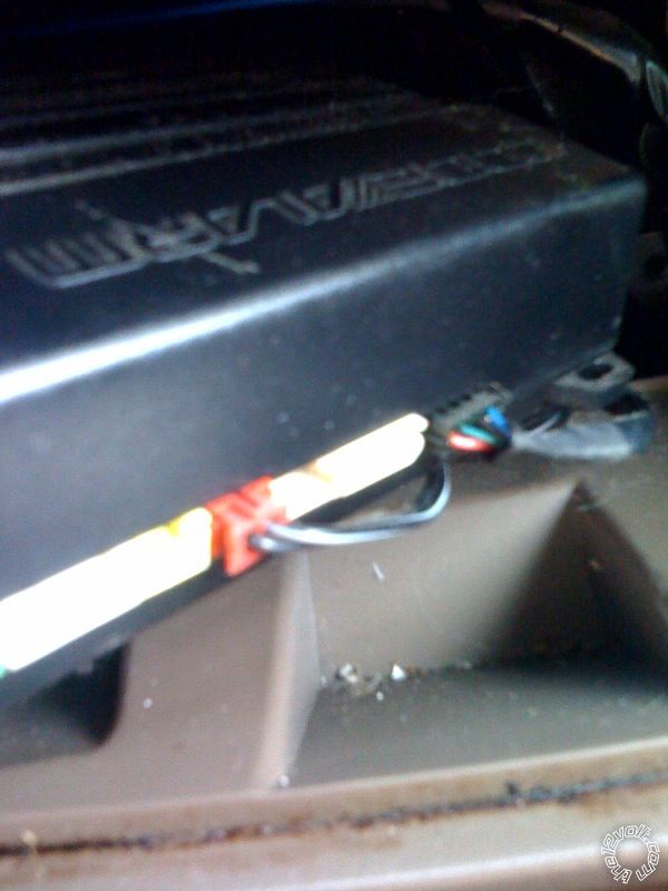

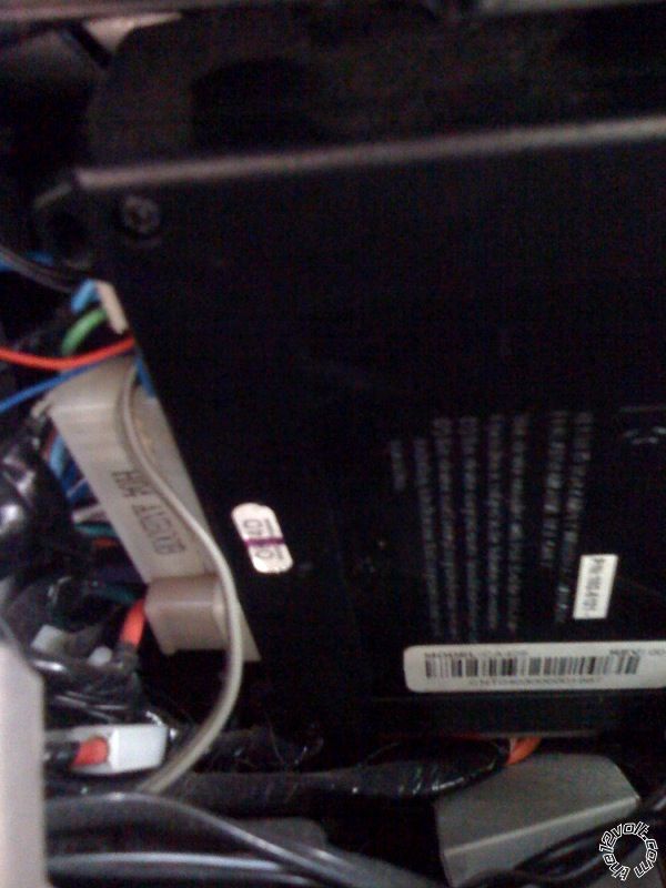

I recently bought a 2004 Toyota Tundra double cab. It did not come with keyless entry remote. I dug around and saw that it has an alarm installed. I opened up the dash and found the module. It's a Code Alarm 425, p/n 102-5121. I've contacted Code Alarm about ordering some replacement parts to get this back to being operable. I have read some pretty bad reviews about Code Alarm, so i'm not counting on them being able to help me out very much. Does anyone have experience with this scenario? Would i need to simply buy a new remote, or replace the entire system? I'm ok with replacing the whole thing if need be. If I bought the same module(s), would it pretty much be "plug-n-play"? Any direction on the next steps i need to take would be greatly appreciated. All i'm really trying to achieve is getting keyless entry, but if the modules/wiring is already there, i wouldn't mind having additional feature. Would it be as simple as just buying one of these?

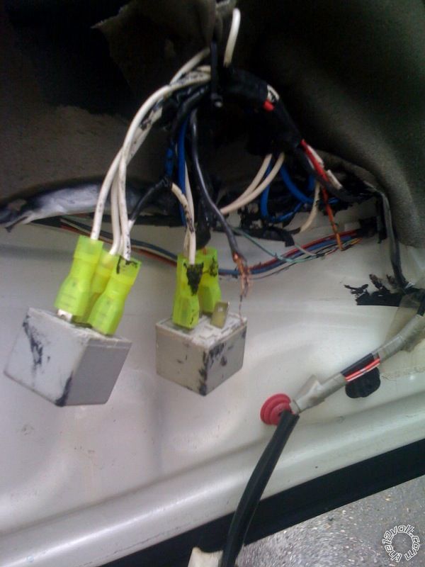

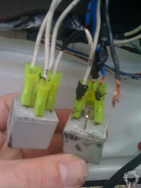

PART 2: I did some more exploring and took off the driver's side door panel and found a couple gray cubes with some half-*** wiring (pics attached). I'm assuming these are for the keyless entry add-on? Check out the pics...where is that black wire supposed to be attached?! For a while now, i've been having some strange behavior with the locks...
- After opening the door with the key, the unlock button does not unlock the other doors. Have to manually reach over and push the lock lever back. However, with the car started, the locks work fine.
- When key is in ignition, if i lock the doors with the lock button, they all immediately unlock. I have to remove the key from the ignition to be able to lock my doors.
These problems must be a result of that crappy wiring job in the driver's door. Any thoughts on how to troubleshoot this? I'm sure it's more complicated than "hook up the black wire where the blue wire is" (that's actually where it looked like it was probably hooked up), but i'm willing and eager to learn more. I'm very inexperienced with alarm systems, but have installed a few audio systems. I'm a do-it-yourselfer, and will research and learn whatever i need to. just looking for some starting points. I'm more than happy to pull off the dash and door again to gather any additional info (pics, diagrams, etc) that will help troubleshoot this.

Code Alarm (aka) Audiovox makes bulletproof equipment. As for the doors unlocking with the key in the ignition....this is a fucntion of the vehicle. It helps prevent you from locking the keys inside the vehicle. I can provide you with proper wiring for the door locks, but since you refered to Relays, as "little gray cubes".....i'm sort of scared.....but i will find it for you. Good luck!

Here ya go! Have fun. Just to add, If I were in your position, I wouldn't even mess with the previous installers wiring. I would just start from scratch.

i found the installation manual. looking at the diagrams, and comparing them to my photos, it appears that the truck is wired for remote start. sweet.
it appears that the CA-425 was the brain of a few code alarm kit model #'s, and they came with different features and remotes. i think all i need to do is re-wire those relays, and then buy and program this remote, and I will be good to go, right? does the FCC ID of the remote that i buy need to match the FCC ID of my 2 way antenna?
Posted: April 18, 2010 at 7:14 AM / IP Logged
Grey cubesused car with alarm, 04 tundra, code alarm -- posted image.

and one more :) ... is it safe to assume that the second relay is for remotely controlling the windows, or could it also be for the locks? my truck is a double cab with 4 power windows, power rear window, and a sunroof.
