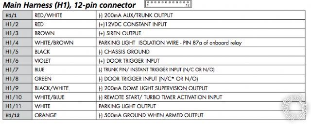

Secound: I've tried to connect the "door Lock". The harness looks like this:
python 991 problems -- posted image.
the problem i've encountered is that the door lock/unlock button only have 1 wire. Where 0ohm is lock and 1800ohm is open? What can i do? Just put a 1800ohm resistans on the wire?

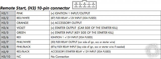

Third:
I wonder if my "understanding of this harness" is correct:
H3/1 - Pink - The cable which only shows 12v at ignition position 1, but zero at ignition 2? (My car i think have 3 positions before the "ignition" is on and ready to start car).
H3/2 - RED / white - I've connected this to 12v constant (just connected it to battery)
H3/3 - Orange - Not needed, gives 12v when i press accessory on the key
H3/4 - Violet - The wire which gives 12v when i cranks the motor
H3/5 - Green - The wire which gives 12v+ to the violet when i turn the key
H3/6 - Red - constant 12v (to battery)
H3/7 - Pink/white - Where does this go?
H3/8 - Pink/black - Where does this go?
H3/9 - RED / black - Constant 12v (battery)

First your door locks. You will need a 451 module or two relays. Your lock output is not strong enough to get past the resistor. Second By-pass? Third have it fitted professionally, don't even attempt it yourself as an example pink goes to the ignition wire (BLACK/ red?) which stays live from ignition through crank, there are many other mistakes in your assumptions.

pink/white 87 - second igntion.
pink/black - not needed
