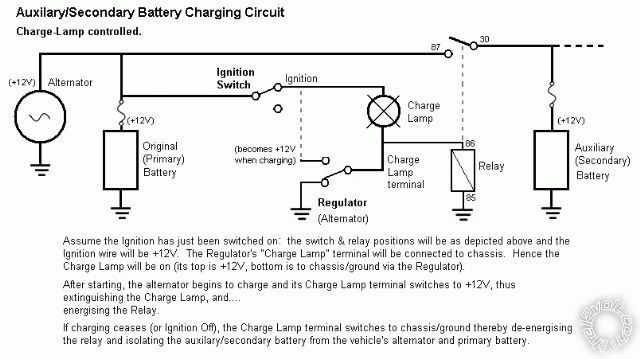

The "Charge Lamp Terminal" is labeled "D+" on most single-wire alternators, and "L" on others.
If your alternator does not have a similar chargeLamp circuit, a voltage sensing circuit (with appropriate time delays) can trigger the relay - that's what commercial Battery Isolators tend to use.
I thought I had relevant writings here on 12Volt, but most seem to be on other forums....
(One day I'll organise a better diagram.)
To recap what I said earlier, batteries should not be paralleled (except when being charged, or being used for a specific purpose - ie, not just left connected together.
