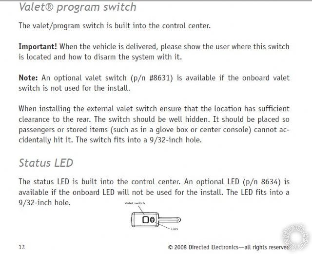

I thought switch.
viper 5701 door lock and unlock only -- posted image.
The picture is from the install manual. Does this connect to the control center by the long, slender key portion or by the electrical connector on the end?

It appears that I may be missing some of the wiring harnesses then. Nothing that I have plugs into the valet switch, but I'll double check everything this evening.
