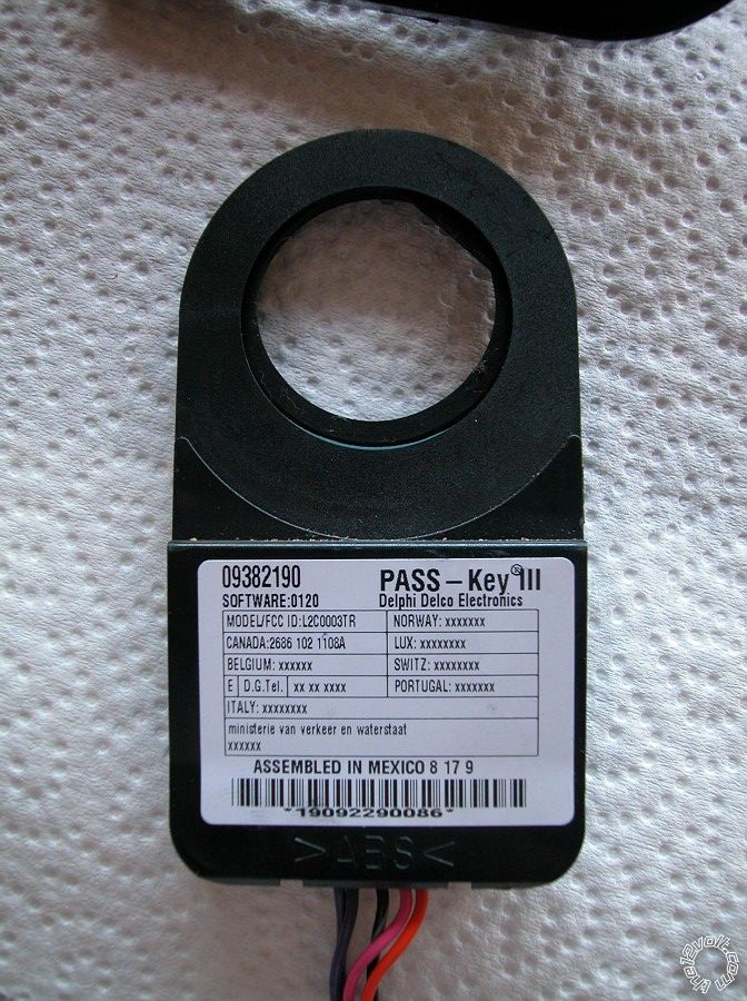

That did nothing. Is this the correct procedure? So I was thinking it could be the module in the steering column. I pulled that out, looks like this.
Passkey III -- posted image.
So can I replace this with a junk yard one? Is there anyway to test it? Since this produces a electromagnetic field, could I check it with a compass?

Replacing the key loop might not do you any good. The vehicle PCM could also give you trouble because that is where the PK3 data is stored for the key learn.

The main reason I think the pickup module may be bad is because this procedure fails. It just acts like it doesn't see the key. I can unplug that module and get the exact same results.

As an update, I went to the local u-pick it lot and got a replacement module for the steering column. Nothing....
So Im thinking key or BCM. Key is cheap, that could be my next try.
