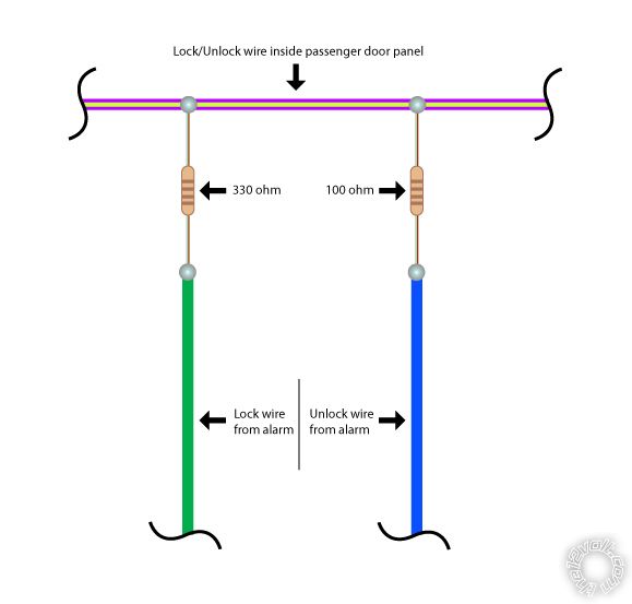

This is the way I have it wired currently, and the locks do not work from the keyfob. They still operate using the door switch. Any ideas?

do the lock and unlock wires from the alarm flop from neg to pos and vice versa, if it does you will need to install diodes with the bands towards to alarm or you can use relays for ground.
How can I test this with a digital multimeter?
johndoby
Member - Posts: 7
Joined: January 04, 2010
Posted: July 07, 2010 at 1:48 PM / IP Logged
Nevermind, I just read this in the manual...
GREEN WIRE: (-)Lock, (+)Unlock
BLUE WIRE: (-)Unlock (+)Lock
So, by having them wired, I am getting a (+) signal to one wire or the other each time I press the button...and by installing diodes in the path of both wires, I will be blocking that (+) signal and allowing only the (-) signal to pass.
Is this correct, or am I completely off base?

That is correct
The flip flop door lock wires can cause a lot of inconsistent results without diodes
