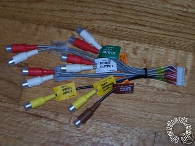

I dont have any pics handy, but the rca's come off a harness and are not direcly attached to the back of the unit. does that help at all? lemme look around online and see if i can snag a pic or 2

avic d2 rca noise -- posted image.
rca's are on a plug like above. hope this helps

Both the D1 and the D2 use a plug similar to that one.  Without seeing the back of the unit, I really can not remember which is easy and which is more difficult.  I may not even be able ot make the determination once I see it.
