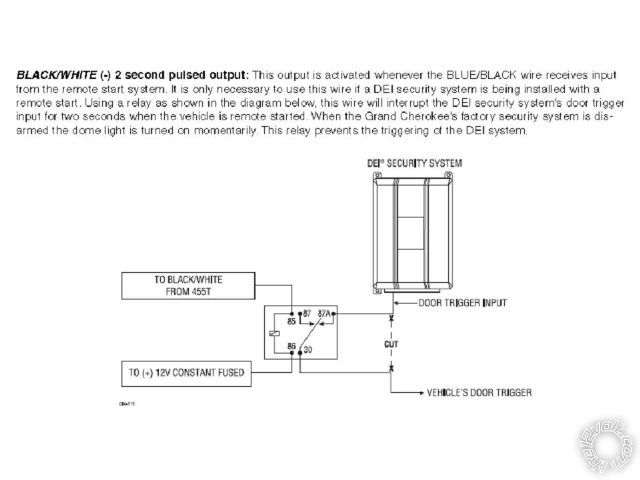

dei 445t 1998 jeep door trigger -- posted image.
I am getting ready to install a 455t and Viper 5301 in my wife's 1998 Jeep Grand Cherokee 5.9 Limited.
What wire (VEHICLE'S DOOR TRIGGER) are they referencing here?
Is it this one:
Door Trigger Negative Wire (-): Yellow
Door Trigger Negative Wire Location: In Drivers Kick Panel
Why does it say "CUT"?
Do they only want me to connect the relay to one side of the wire?
Which side?
Thanks,
LittleG

The paragraph at the top of the page pretty much explains it all... but here goes....
When you disarm the factory alarm, the dome light comes on, the viper alarm will think that the door was opened and the alarm will trigger.    Using this relay configuration, you will interrupt the door trigger to the alarm .  Yes, the yellow wire you listed, will run thru the relay to the viper alarm,
I know I didnt explain it so good.

So one side of the yellow wire will connect to #30 on the relay
And the other side of the yellow wire will connect to #87a on the relay with the door trigger input from the Viper 5301?
It's like there is a piece of wire missing in the picture?
So when I cut the yellow wire, which side goes to #30 and which side goes to #87a?
And the side of #87a am I soldering the yellow wire to the input of the alarm wire?
I don't know why this is confusing me so much?
Thanks,
LittleG

The door trigger - input wire from the alarm should connect to pin 87a on the relay . You dont need to actually cut the vehicles factory security systems yellow door trigger wire , just strip a bit of the insulation from it , wrap a wire running from pin 30 on the relay around the wire & solder .
Pin 85 goes to the black with white stripe from the 455t . +12v constant fused to pin 86 .
It just interupts the dei alarms door trigger wire when the system is remote started or disarmed.
The reason it says CUT is to illustrate the alarm - door trigger connects thru a relay before connecting to the factory alarms door trigger wire .

I don't understand why that part is necessary, when you are not installing a dei security system.  What you have is a 2 way keyless and r/s.  Unless, you already have a security system and are adding to it.

Thanks dodgeram10 that make more sense!
