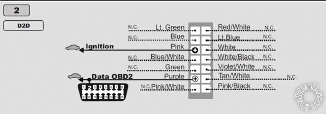

viper 5701, yukon, buick -- posted image.
I connected D2D module to the Viper 5701, from what I am looking at theres only 2 wires to connect. Where do they connect on the yukon ?
yukon 2001
Platinum - Posts: 7,828
Posted: October 06, 2010 at 7:35 PM / IP Logged
Ignition 1 goes to the Pink wire at the ignition switch harness.  Should be the same one you used for the Viper Ignition 1 connection, H3/1.
The Data OBD2 goes to the OBD connector Pin 2 under the steering column.  Its the "Diagnostic " connector...
Posted: October 07, 2010 at 5:15 PM / IP Logged
Yes, that's it.  Bottom of the drivers side lower dash panel.  The shape is the same as the instruction diagram.
