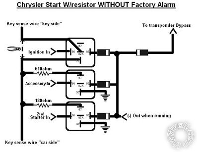

It looks ok not the greatest security module but it will work. here are some better diagrams.
 The key sense wire is the mux wire or the PURPLE / Brown wire
remote start, 2006 grand cherokee -- posted image.
The park lights can be done negative trigger at the relay.

Thanks for the help.  I'm going to return the BYTRAN (bypass made by Stellar) and get the PKUMUX instead...save myself the hassel of wiring all the relays.  Thanks for the help though, much appreciated.
Question: I asume I will still use the RS1050 RED / Black to connect to the PKUMUX Blue/White?
Also, thanks for the parking relay tip.  I didn't really want to have the hazards flashing the whole time anyways.  I asume I use the RS1050 RED / Black to connect to activate the parking light relay (pin 1)?
