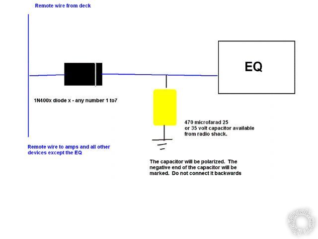

Temporarily, for troubleshooting purposes only, connect the EQ's remote wire to constant voltage so it will not turn off.  Does your amp still pop when turning it off?  If it still pops, the problem is not associated with the EQ.  If it does not pop, I can help you with a circuit to keep the EQ powered up untill the amp turns off.

sub thumps at turn off -- posted image.
Platinum - Posts: 13,725
Posted: April 03, 2011 at 5:47 PM / IP Logged
The above diagram will help you only if you have determined that the EQ turning off is causing your problem.  The circuit will allow the EQ to remain on until the amp turns off.
