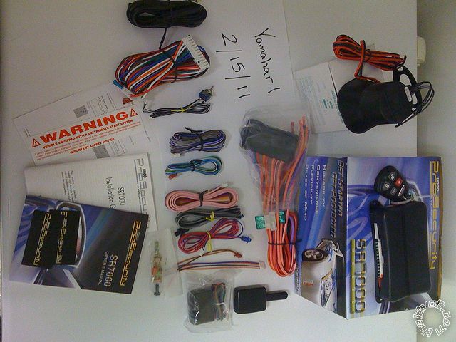

This is very confusing, marketed by Clarion, it looks identical to the previous generation Viper/Hornet product with satellite relay box. ungo.jpg

All of my manuals and paperwork on the units say Directed on the bottom of them.
