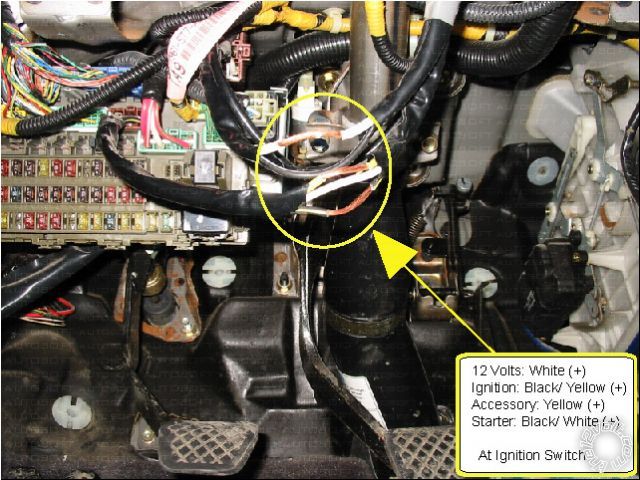

I just purchased a viper 5902 for my manual integra everything is wired correctly now i was wondering how do i go about installing the remote starter is there a specific wiring diagram that i can use or anything extra i need to make it work

the alarm is already installed it locks and unlocks all i want to do now is just wire the remote starter

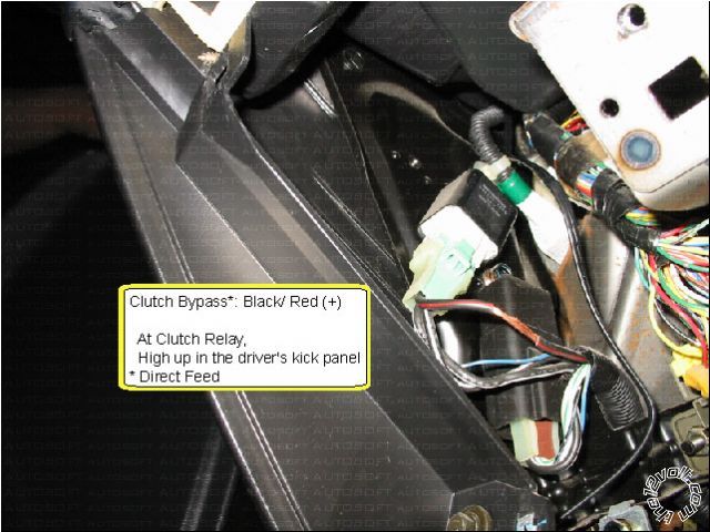

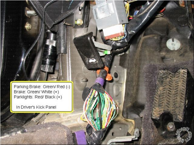

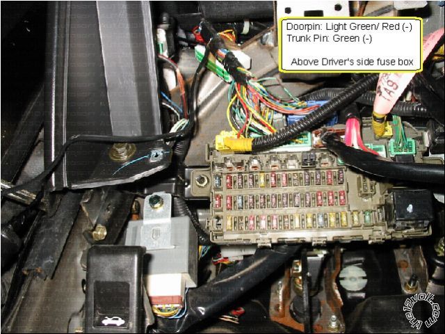

Posted: April 24, 2011 at 9:05 PM / IP Logged
5902 on manual integra -- posted image.

so pretty much just wire just like the diagram and thats it correct or do i need a module to bypass
syl20rochon
Copper - Posts: 298
Joined: October 16, 2009
Location: Ontario, Canada
Posted: April 24, 2011 at 9:20 PM / IP Logged
I would recommend you getting the idata link ADS-TB. Easy to install and you don't need to sacrifice a key.
