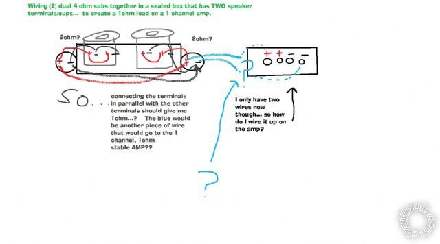

wiring on sealed box
harobikes333
Copper - Posts: 53
Joined: May 08, 2009
Posted: May 31, 2011 at 9:18 PM / IP Logged
wiring on sealed box -- posted image.
Platinum - Posts: 13,725
Posted: May 31, 2011 at 9:51 PM / IP Logged
Both positive amp terminals are connected together inside the amp.  Same with the 2 negative terminals.  It does not matter which + or - terminal you use.

Posted: May 31, 2011 at 10:03 PM / IP Logged
Alrighty but otherwise it looks good...?   I'm attempting to get my ohm meter to read 1 ohm but it just says 0 ohms or .1 ohms if i'm lucky >_< ?
