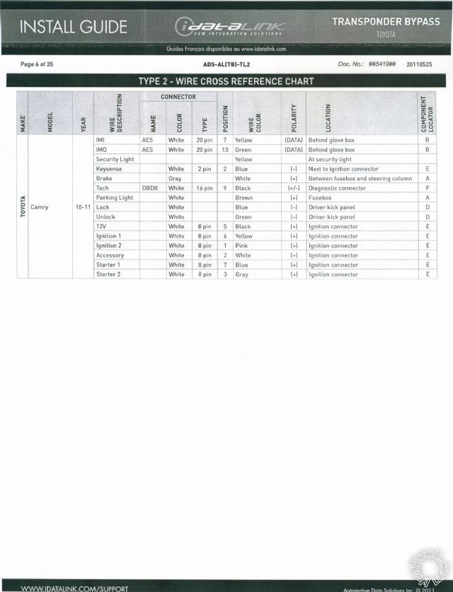

Installed Viper 5901 with Idatalink ads-al(TB)-tl2 on Camry 2011 "G" Stamped key
2011 Camry Std.key 80-bit Sedan Automatic 4 Cyl with no push to start
When I press remote start the starter begins to crank but no start. As soon as I put in the key (without turning it to on) the car starts.
5901
H2/10 Dark Blue   to Blue wire at ignition    Camry
ADS
GWR Blue/White   to Blue wire at ignition    Camry
I did not use the diode that is listed in the diagram because i have read in another post that it is not needed. Could this be my problem?
Another question I have is for the door locks. I found the blue and green wire but I'm not getting a negative reading. I have connected them directly to the 5901 and they do not lock or unlock.
Thanks in advance.
'11 toyota camry rs cranks no start -- posted image.

The diode is to prevent the Keysense signal, created when the key is in the ignition switch, from turning on the
bypass module.  I would install a diode or, in the case of a Viper 5901, if you are not using the H2/16 Blue/White
wire for the defrost function, you could use it as a second (-) Status Output.  ( H2/10 for the bypass & H2/16 for Keysense.)
A few question about the bypass.  Assuming you are running in W2W mode from the (-) Status / GWR wiring.
Is it downloaded / flashed with the ADS AL(TB)-TL2 firmware?
Did you set its' mode to "Standard", two blinks?  Top of Page 34
Did the bypass program as per the instructions in the install guide?  Bottom of Page 34

The Viper has two (-) Status Output wires, H2/10 and H2/16.  You can connect H2/10 directly to the ADS (-) Blue/White GWR
input wire.  ( Also connect the dashed Power and Ground wires for W2W. Follow the Type 2 Install diagram. )
Verify that the Viper programming for Menu 3, Item 11 is set at the factory default of Opt 1 (-) Status and
connect that to the Camrys' Blue Keysense wire.

The Diod is not going to stop in from cranking, I probably would use it but it should still start. The fact that it will remote start with the key in the switch means that it is not bypassing the security. I would try going through the programming process and key learning again. also double check all of your connections including the security light from the bypass mod, it does matter.

In that car I thinks its up high on the dash. if you set in the car with the doors shut and lock it with the factory remote it should start flashing. you actualy have to tap it at the light. Did you follow the programming chage that kreg357 mentioned when you use that wire? Me personaly I would have just put the diode in insted,

Did you connect the iDatalink bypass to the car as per the Type 2 wiring diagram?  Did you program the iDatalink bypass module to the car as per the instructions on Page 34 of the Install Guide?
Did you connect the Viper Tach Input wire, H2/9, to the Camrys' Tach source?  Did you program the Viper for Tach Mode? ( Menu 3, Item 2, Option 4 )
Did you do a Tach Learn process on the Viper?
