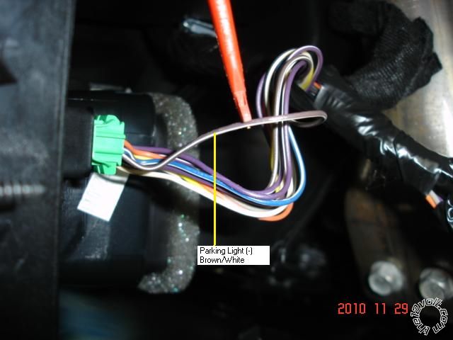

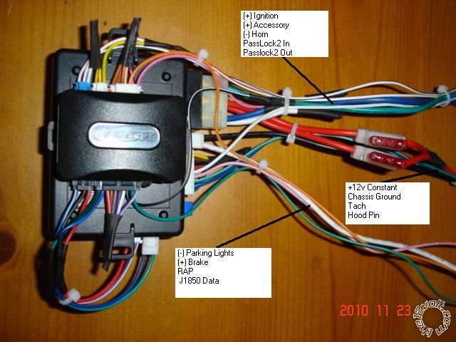

 Here are a couple more pictures :
2004 GMC Canyon Pickup Passlock II -- posted image.
 (-) Parking Light     Not sure why this picture isn't showing up.........     I can EMail it if you need.
Enjoyable vehicle to do.
