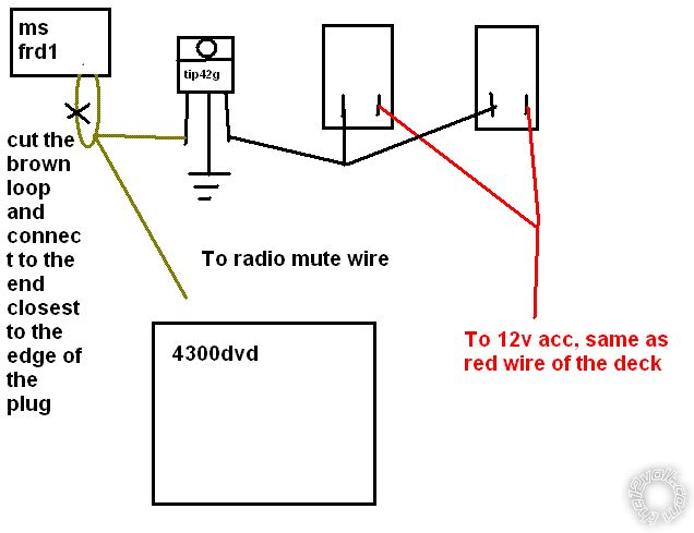

What was done to fix the problem:  I had to use a transistor and 2 DPDT relays from Radio Shack to completely bypass the module with all amp wiring.  I will post diagram for the transistor.  Transistor is triggered by the brown wire of the pac module.  Same wire that mutes the deck.
Relays wired as follows:  Common terminals to speaker wires.  Only front channels need to go through relays.  Rear channels can not go through the module, just wire the rear speakers directly to the amplifier.
Normally closed contacts to the output of the amplifier.
Normally open contacts to the output of the module.  This is only needed for bluetooth phone operation.

pac ms frd1 and 4 channel amp -- posted image.
I did not get a layout of the relay from Radio Shack.  They did have a picture, from what I could see through the smoked plexiglass cover, this should be accurate.  Check against this info before wiring it up.  Top set of contacts should be the NC (Normally Closed) contacts.  Just below that is the NO contacts.  Then the Common contacts.  Coil connections are at the bottom of the relay.

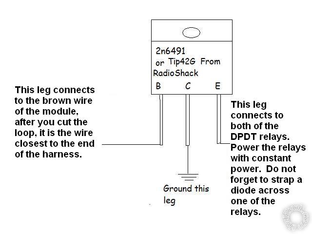

I forgot to draw the diode on the diagram.  It needs to go across the coil of one of the relays.  The end of the diode that has the band on it MUST be connected to the terminal that has positive voltage.  The transistor does not need a heat sink.  The tab of the transistor is connected to the middle leg.  There is ground on the tab.  If you want to mount it to a bracket or directly to the chassis, that will be fine.

I looked at the pictures you sent.  The above diagrams are exactly what you need.
Did you buy the exact part number relay I suggested?  They sell a 3 amp and a 10 amp device.   The pic looks like it may be smaller in size than the ones I have used.  if it is the 3 amp unit, I have no idea how long it will last.
