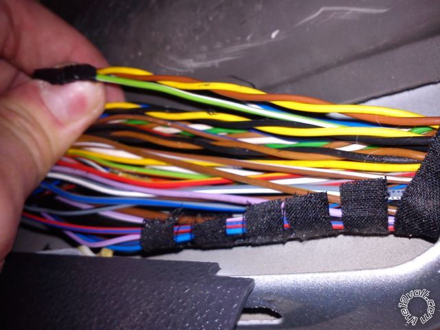

No, driver's FLOOR loom. If you pick them up in the door loom you will only operate the driver's door.
Posted: October 14, 2011 at 7:16 AM / IP Logged
Look to the left in that picture, that's the loom, follow it down to just in front of the driver's chair where you can pull it up to extract it. Open it (fan out the wires) and I'll point them out to you.

vw polo door lock/unlock - Page 2 -- posted image.
Really hope this is the one, I have cut almost all car wires :D

In your picture, the one in your hand is one, the other lurking there is I think the grey/white or WHITE/ grey.
also in that loom, BROWN / white, one of two, all door trigger, if you have a light in the hatch the trigger is a thin yellow black and your two indicator wires, BLACK/ white and BLACK/ green also. Any plain brown is your ground (earth or 0v) and any plain red your 12v+ supply, plain black your ignition.
