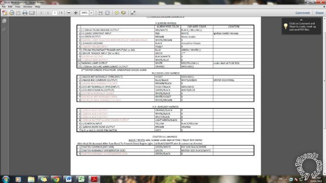

Hi, that's my first topic on this forum. So, please, don't judge me too hard python 323, avital 4003, pkh34 -- posted image. Correct me if I did something wrong python 323, avital 4003, pkh34 -- posted image.
Here is my problem. I just bought a Python 3203P (model 323) and about to install it myself. I've got wire guide for my 2004 Honda CR-V (thanks to https://www.the12volt.com, but the wire guide I got with alarm is a bit confusing to say at least. Eventually I was able to figure most of wiring out, but diagram doesn't show or explain where I suppose to connect 2 accessory wires from Honda. It shows none! And also what are those "Flex Relays"? How can I use it? Called Directech-no help, they said Pythons intended for only professional installation so they are restricted to give me information on installation! Total BS!!! python 323, avital 4003, pkh34 -- posted image.
Here is what I was able to figure out. If anyone could check if I got it right I would really appreciate! python 323, avital 4003, pkh34 -- posted image.

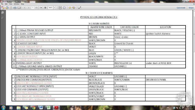

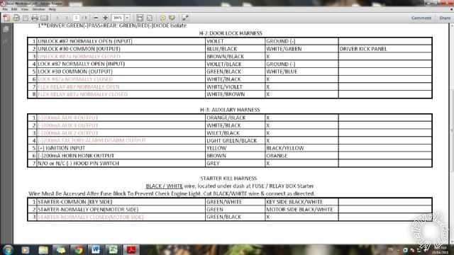

Sorry for quality, but that is the best I could come up with...

Posted: October 14, 2011 at 4:49 AM / IP Logged
Is this an alarm or an R/Start. If you're using it as an alarm the ACC x 2 aren't relevant.
Also on the starter kill harness use 3 instead of 2 it's safer.
Everything else looks OK except the orange GWA. That should NOT be grounded, it's used for triggering accessories such as window closers.

Posted: October 14, 2011 at 1:37 PM / IP Logged
No it isn't. Used for accessories such as window closers. You only need to use 1 and 3 of the starter kill.
You will eventually use the flex relay for ACC 2.
