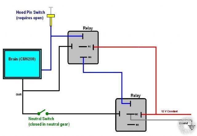

Ball Switch - When truck is in neutral, switch closed, any other position, open.  Reason for this, if switch fails, or has any issues, closer circuit should not be active, therefore, should disable my remote start.  Sort of a fail-safe such that if not 100%, it's 0%.
GWR (Ground while running) - Available and operatable from CM6200 brain.  Only shows ground feed while remote start is active - Open when truck is off, Open when key is "On".  I would like to use this, such that I suspect a relay or 2 will come into play for this and would prefer the system to just do a "check" for neutral, instead of powering relay coil on and off while driving the truck, and also, do not want it powered while engine off (battery drain).
Hood Switch Pin - Operatable now.  Requires to be Open to enable remote start.  When it sees ground, constant or momentary, remote start is disabled, and reservation mode (due to manual transmission) is cancelled.  This is the tricky part for me, because circuits I have started with have all yielded somehwere in the timing of it all, a ground connection to this wire.
       So this is my biggest problem really, neutral swtich is "closed" when ready to start (neutral), yet my hood pin switch requires "open".
Hood Swtich Pin - Continued - I would like to use this particular wire simply because my Drone Mobile App can retrieve the status of my hood.  Therefore, if my truck is in gear (my reservation mode will be cancelled and won't start), it will tell my "hood open", therefore, I can take this as a "truck in gear" status (though it could be my hood as well, but you know what I mean).
Have been thinking for days, just about full of gray hair now!  Jk, but i certainly would apprecaite any input to this scenario.  Slightly easier terminology is apprecaited as I am not exactly trained in this stuff, just stubborn and persistant enough to keep plugging away at it until it works.  And its kinda fun!
Thanks everyone!  Sorry for the length, but one thing I have learned is more info the better!
Weird, before I posted this, I was re-reading and thought of a possible way.  I have it drawn out, forgive the diagram, not exactly "professional".
I am believing this might work, but would like confirmation....what do everyone think?  Thanks!!!closed switch to open signal -- posted image.

I think I understand your first bit there, however the problem with that is my switch is a closed circuit when in neutral.  Putting this to ground would be a 180 of what I need?  Maybe I dont understand.
I hear ya about reverse light / switch.  What I really meant was, I could easily use the reverse light as a signal, however that would only cover my reverse gear, and not the rest.
Lets just say for kicks and giggles, that there is no NSS on my vehicle, may I have your opinion on the diagram above?
If that does suffice, I just want to be sure that it will be safe and not drain my battery.  Which I believe it should be good?
Thanks!

I don't understand your post. I know that a closed circuit has "continunity" per say.  But that is the problem.
If I don't use that diagram, then when in neutral, my switch is closed.  Therefore, if it is going to ground, my hood wire will have ground when in neutral, which means my truck will not start - reservation mode cancelled.
Unless, you are referring to your suggestion about the light blue wire above.  Which I believe to be the brake wire.  Does that light blue wire see ground when brake pedal is pressed?  12v? or open?  I need to look into that particular scenario more to understand.

Posted: October 29, 2011 at 1:42 PM / IP Logged
Please forget my last post! I was wrong, this is what you need to do:-
At rest the NSS (or ebrake) wire sees 12V+, thus disabling the RS. The black GWR wire changes the relay so that 30 is now connected to 87.
Of course that wire at 30 won't see a ground, STILL disabling the RS until the gear shift is in neutral.
As a double redundant safety, I just revised the diagram allowing blocking diodes. :- F6E_nss.bmp
Sorry about that, it's dinner time here and I'm thinking this through and designing the circuit as I write!
