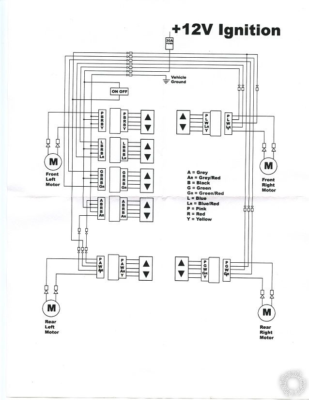

Posted: November 14, 2011 at 6:35 PM / IP Logged
havent tried the logic analyser yet,
but i did get the diagram... even though it doesnt tell you what kinds of diodes to use.
any suggestions?
Power Window Kit, Wiring Diagram Lost -- posted image.
Posted: November 14, 2011 at 6:59 PM / IP Logged
This is a bog standard window system type "A" negative at rest. Same wiring as most vehicles without comfort control or one touch.
What diodes? There aren't any in that diagram, incidentally what logic probe? All you would need for this set-up is a 12v test light.
