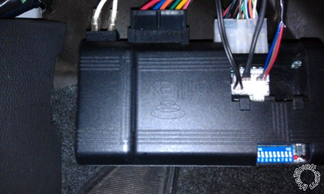

Ok the car started using the remote with the key in the ignition. Here is a picture of the device that shows the light blinking 4 times. So what do I do next?

So Mike M2 any solutions you may have would be appreciated

Another note to add is the remote start did work in this car, but all of a sudden it stopped working. And like I said the blinking lights ( 4 blinks) must be a code of what the problem is. Does anyone have any ideas?????

Like he said, it is a bypass issue. Do you know what bypass is being used? It should be an additional little box somewhere near the starter.

I can't seem to find the bypass unit. I tried a reset to the brain dip switch 7. Now the brain is blinking like 19 times.
