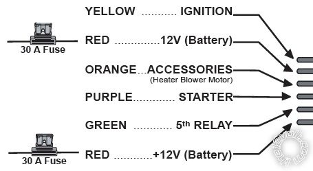

Also, you say 'while running' is BLUE from the Python, however I don't have a Python, I have a ProStart (http://www.autostart.ca/prostart/prod-en_CT-3200.php and attached picture of wiring). I don't see a 'status output' wire from the remote starter. Could this be going to a different wire on this unit?

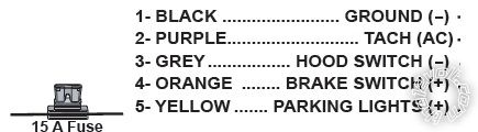

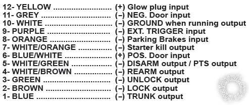

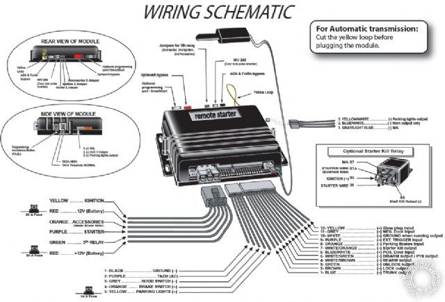

Thanks again. Sounds like all these wires are in the steering column?
Still though, how about the: "(3) while running(-)" wire from the PKALL.
Where does this connect? I have a prostart remote starter, there's no sign of a "while running(-)" wire coming out of it, unless it's called something else. Here's the wires I have coming from the prostart:
2009 vibe remote start -- posted image.
buddholly
Copper - Posts: 244
Joined: August 24, 2006
Posted: December 16, 2011 at 3:45 PM / IP Logged
Use 10- White.....(-) GROUND when running output.
