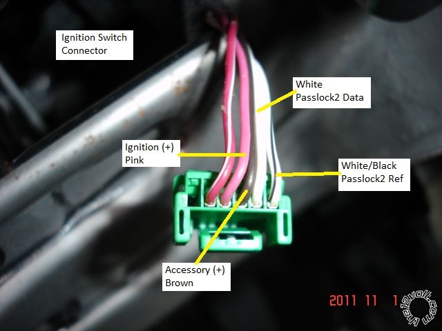

As far as the ignition and acc wires I was referring to this.
You may be able to find the wires and tap them elsewhere but I wasn't going to chance it I guess.

Thats good to know about the ignition wires. I will probably just go to the switch to play it safe.
