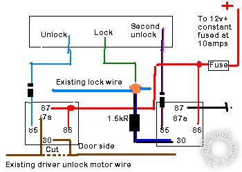

My Python 533 has a wire for a -200mA 2nd unlock output. Do I need this to unlock all the doors at once or can this be accomplished with programming the module for 2, instead of 1, unlocking pulses on the relays? Its confusing to me because, if so, I dont see a point for the second wire in the first place.

1) The second wire is for priority unlock. i.e. driver's door initially, then the others only if you activate 2nd unlock.
You will have to slightly mod your 451 but here's how:- 9A9_multiplex_priority_unlock.bmp
Note you are going to have to mod the 451. One, either the violet or violet/black (the lock side ) goes to ground, the other side goes to 12v+ constant.

Then ignore the second unlock wire, just leave it as was before.

Ok then I will just hook up the door locks as normal and change the programming for 2 pulses. I will also take the pink from the PKALL and take it to the regular ignition wire. I figured it might cause some issues, glad I asked! As for the WHITE/ blue, I guess I will get a momentary switch eventually so I can hook it up. I dont think I will use it ever, it may be useful for testing the system if I ever need to.
