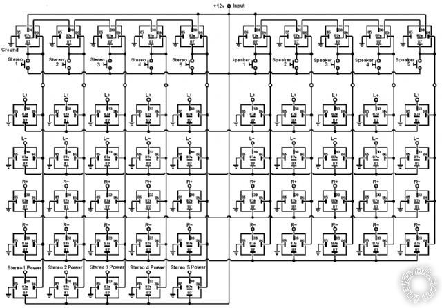

I just started working at a small shop here in Nebraska and we don't have a switchable display and I want to make one. I did search and found THIS. When I tried to make the latched relay part to see if it worked I could get it to go from 5 down and it would release the previous relay but if I start at 1 or just try to go up the chain to the next relay it won't release the previous relay. I can see why it is doing what it is doing. It will release the higher relay because when the lower is energized the delay in the switching breaks the 12 volts but it won't do it going the other way. How do I fix this?

I have it figured out. I will have to use HWW diagram here that uses two relays and just diode iso all the unlatch triggers. I will keep you posted with pics once this is started.

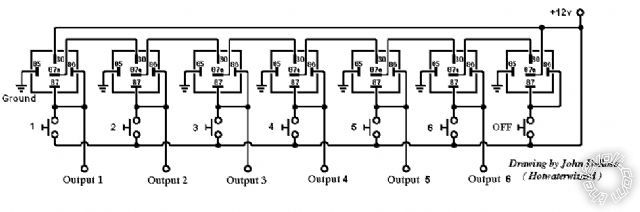

Okay Here is the best Fix I could figure out for you.
Add an extra button and relay to reset off.
Then select which one you want.

If did it that way I wouldn't want to make the off one latched. I think I'm just going to use this relay setup
display board relay setup? -- posted image.
it will take a bunch of diodes to do the unlatching but it will work like I want it to.

The problem is that my diagram is a concept.
 I never built the circuit.
You went that extra step.
 Please let me know how it works out.
