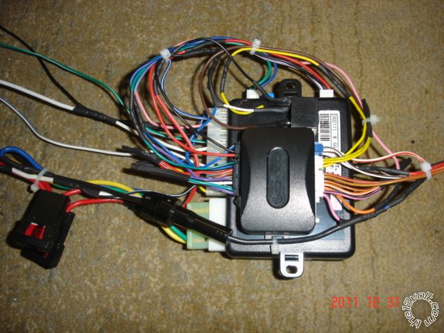

Here is a photo of an ADS AL CA w/CH5 firmware mated W2W with an Ultra Start remote starter w/Keyless ready for install into
a Jeep Patriot :
07 dodge ram 3500 viper 5501 idatalink -- posted image.
Make sure you set the iDatalinks' Installation Mode to Standard ( 2 blinks ) and lock it in.  Then program the bypass to the truck.
